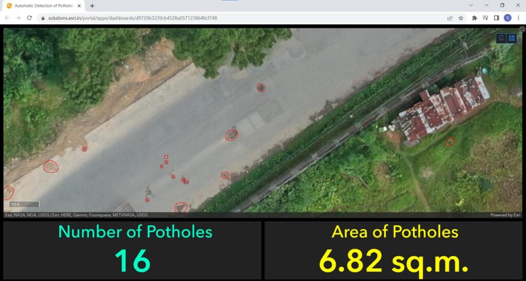

This blog describes an approach to detect and locate potholes using high resolution imagery and deep learning tools in ArcGIS Pro Image Analyst. The workflow can help local authorities build a pothole detection system with adequate accuracy and speed, where assessment of magnitudes of potholes can also be carried out.

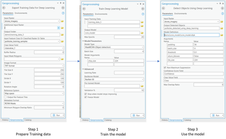

A typical deep learning workflow includes the following steps: 1. Prepare data, 2. Train the model and 3. Use the model. Let’s see how we can carry out the workflow in ArcGIS Pro Image Analyst. These tools are also made available in ArcGIS Enterprise with ArcGIS Image Server (Raster Analytics), ArcGIS Online with ArcGIS Image for ArcGIS Online , and arcgis.learn module in ArcGIS API for Python.
In this workflow, I am interested in identifying potholes and get insights about the severity of the detected potholes using ArcGIS Pro.
Using Label Objects for Deep Learning pane or the Training Samples Manager, we can collect training samples of the feature of interest (i.e., potholes). The next step is to export the training data in the right format – here we will be exporting the data as RCNN Masks to get the exact polygon boundary of the potholes. ArcGIS supports several other metadata formats and deep learning model types. Check them out here. Now a MaskRCNN model can be trained using “Train Deep Learning Model” geoprocessing tool. The output from this tool can be used in “Detect Objects Using Deep Learning” to detect potholes in the input high resolution imagery.

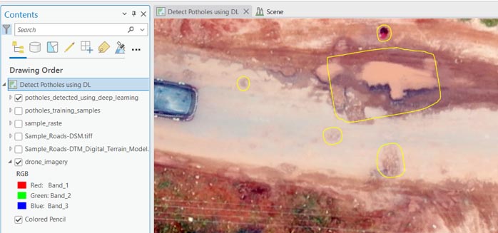

Let us look at some of the potholes that are detected by the deep learning model.
To assess the severity of the potholes, we can carry out volume estimation with digital elevation models using geoprocessing tools such as Raster to TIN, interpolate polygon to multipatch, minimum bounding volume in model builder or a custom Python script.
