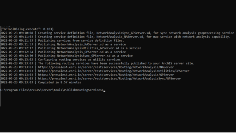

The following example shows how to call the Publish Routing Services utility on an ArcGIS Server site that is federated with a portal.
In server machine command prompt, run the publishroutingservices.bat with the necessary credentials as given below:
publishroutingservices.bat -s https://presales4.esri.in:6443/arcgis -P https://presales4.esri.in:7443/arcgis -u portal admin -p secret -o C:\RoutingServices\ServiceDefinitions -n C:\Users\soiadmin\Desktop\NetworkAnalysis\Routing.gdb\ Road_Route_Network\Route Network
The above steps should publish all the routing services as shown below.

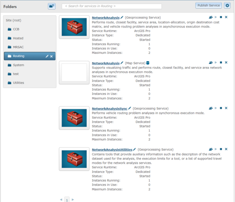

In ArcGIS Server Manager page, take a look at all the services created by the utility –
If your ArcGIS Server is federated, the tool registers the routing services as portal utility services.

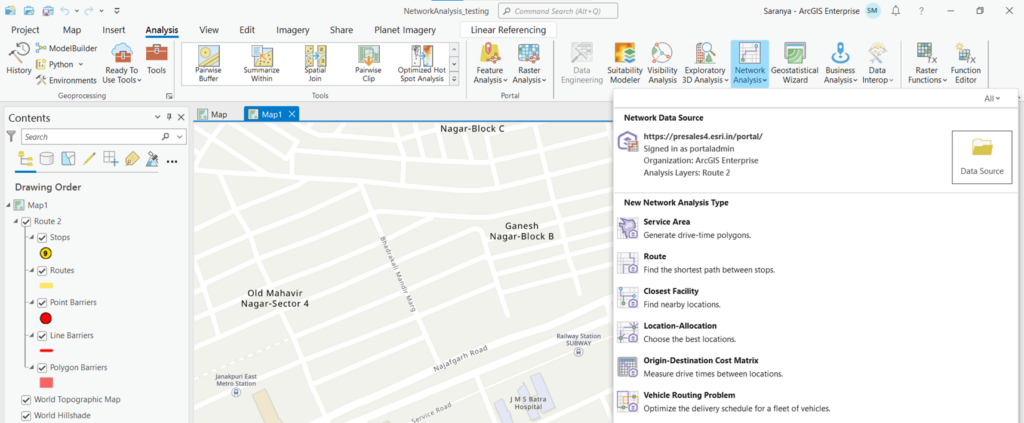

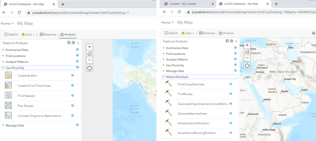

These services can now be used in Map Viewer, ArcGIS Pro as well as in ArcGIS APIs & SDKs.
