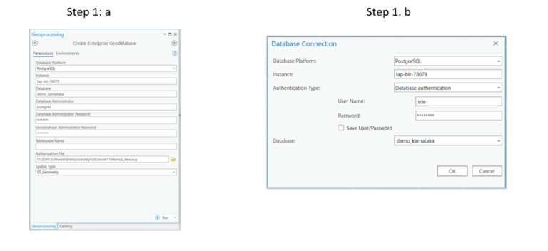

Step 1. Create Enterprise Geodatabase and add it to ArcGIS Pro the client application through Add Database Connection.

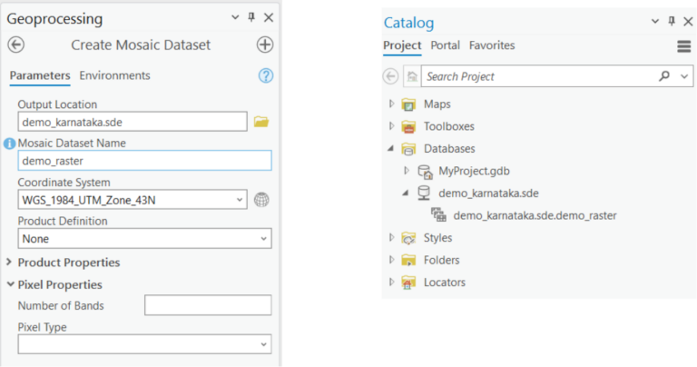

Step 2. Create Mosaic Dataset in Enterprise Geodatabase
fig-2-mosaic-dataset

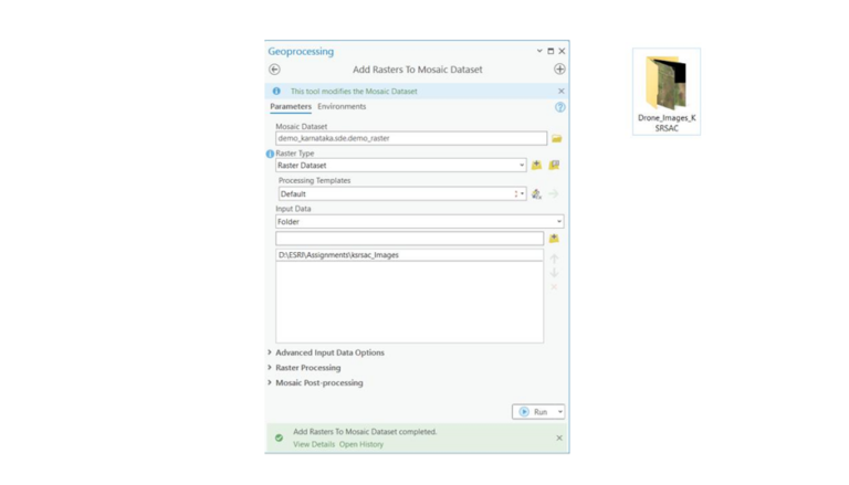

Step 3. Add Raster to the mosaic dataset from the folder contains Images that saved in the server
Figure-3

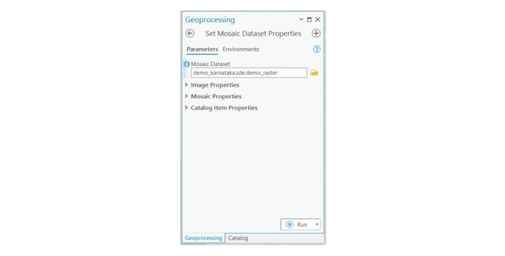

Step 5. Set Mosaic Dataset Properties with preferred settings that defines the defaults for displaying a mosaic dataset and serving it as an image service.
Figure-5

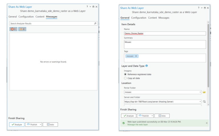

Step 6. Share as web layer – The mosaic dataset can be published with following settings

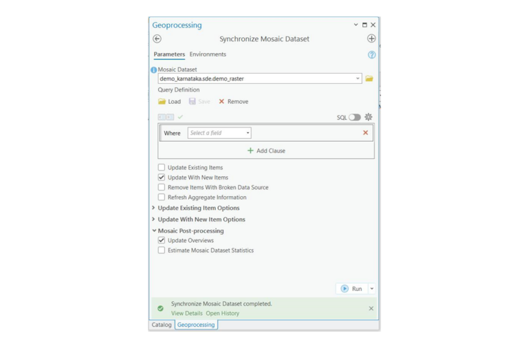

Step 7. Synchronize Mosaic Dataset
Synchronizes a mosaic dataset to keep it up to date. During the process, in addition to syncing data periodically, you can update overviews if the underlying imagery has been changed, generate new overviews, and cache, and restore the original configuration of mosaic dataset items.
