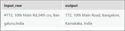

We tested it with a sample address and obtained the following result: “#772, 10th Main Rd, 34th Crs, Bengaluru, India”

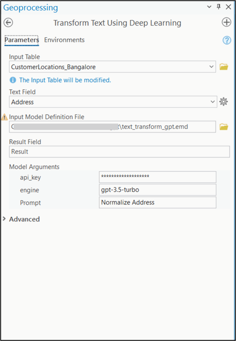

Then, using the Transform Text Using Deep Learning tool, we selected the survey data, gave the prompt and then ran the model.

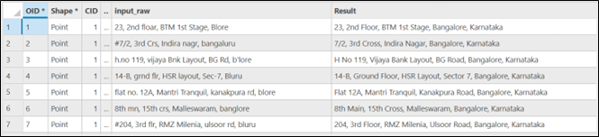

Fig 6 - Table With Results

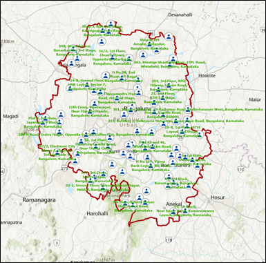

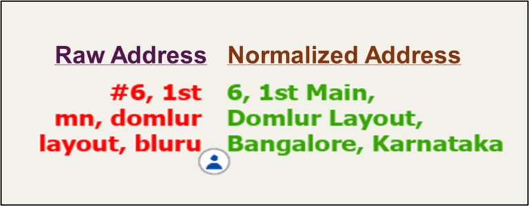

The results were impressive. The model gave us clean, complete, and corrected versions of each address—fixing spelling, expanding short forms, and even filling in missing city names.
