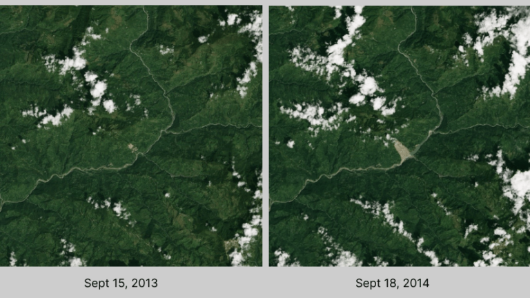

The two JPG format images shown above were obtained from the Landsat image gallery, which can be accessed and downloaded from the provided link: “https://landsat.visibleearth.nasa.gov/view.php?id=88319“.

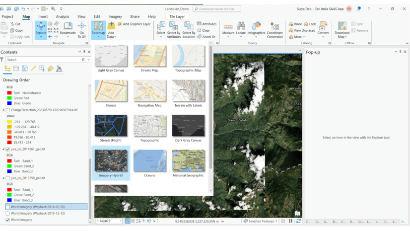

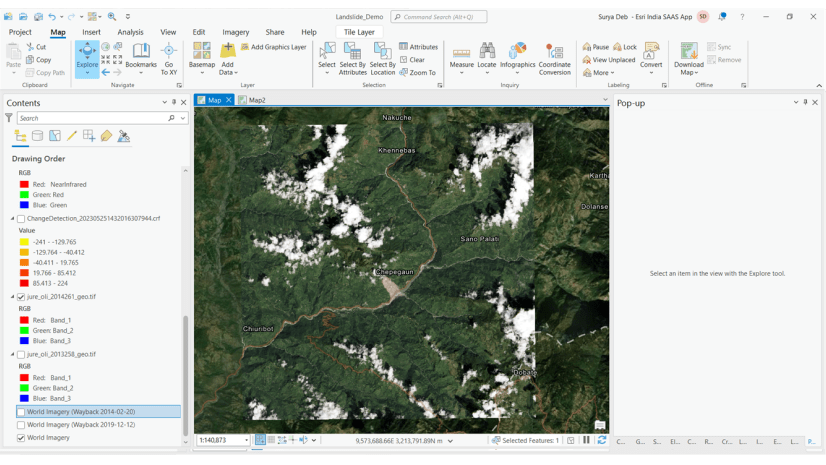

To determine the location of these images, open ArcGIS Pro. Open the downloaded images in ArcGIS Pro to view the specific location. This will help you understand the area the images belong to. You can use the base map option in ArcGIS Pro to identify the location by selecting the Image Hybrid option. This will provide nearby location names, this place is located in close proximity to Chepeguan, Nepal. Search accordingly and note the location name.

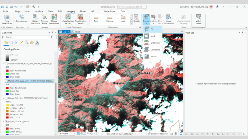

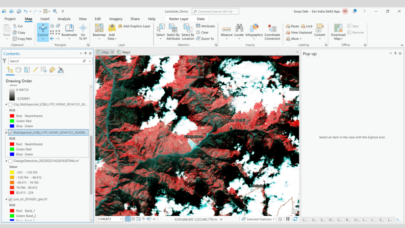

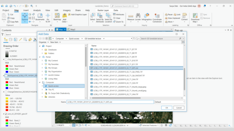

First, Open ArcGIS Pro then I select add data and select mtl.txt file of the downloaded satellite image.
06_826x465-remote-sensing-analysis-with-arcgis-pro

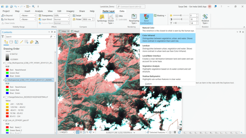

Now select image, go to raster layer and select band combination and then select color infrared.

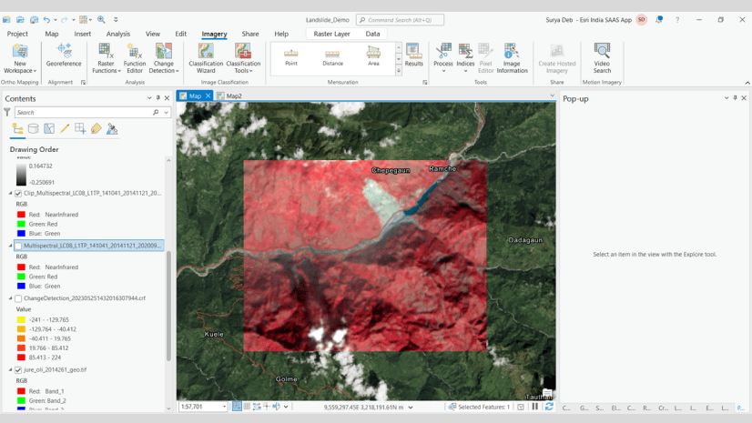

To extract information from the single image, you can subset the material by using the clip tool. This will create a clipped image of the desired area. Further analysis and processing can be done on this clipped image.

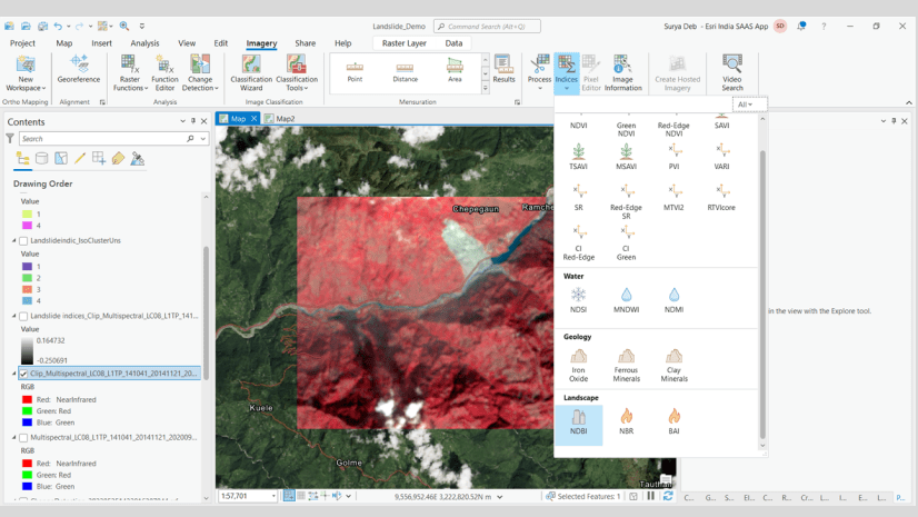

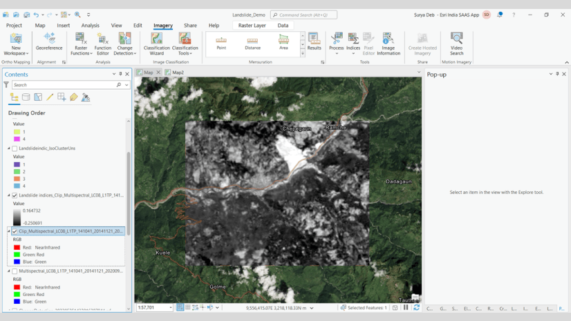

To extract the slide area, we can now apply indices to the selected clip image. To begin, navigate to the “Imagery” section and proceed to the “Indices” tab. Instead of using NDBI (Normalized Difference Built-Up Index) typically employed for identifying buildings, our focus here is on extracting the slide area. For this purpose, we require the SWIR (Short-Wave Infrared) and NIR (Near-Infrared) bands. Thus, we will utilize the direct tool, NDBI, to facilitate the extraction of the slide area efficiently.
To calculate the area of the slide, you can apply indices to the single image. Select the shorter wave Infrared band and the infrared one band for the calculation. One suitable index is the Normalized Difference Built-up Index (NDBI), which is sensitive to sand particles. This index will highlight the target area.
To automate the process, you can use the available indices in the imagery toolbox. Select the NDBI index and apply it to the Landsat image. This will highlight the slide area.

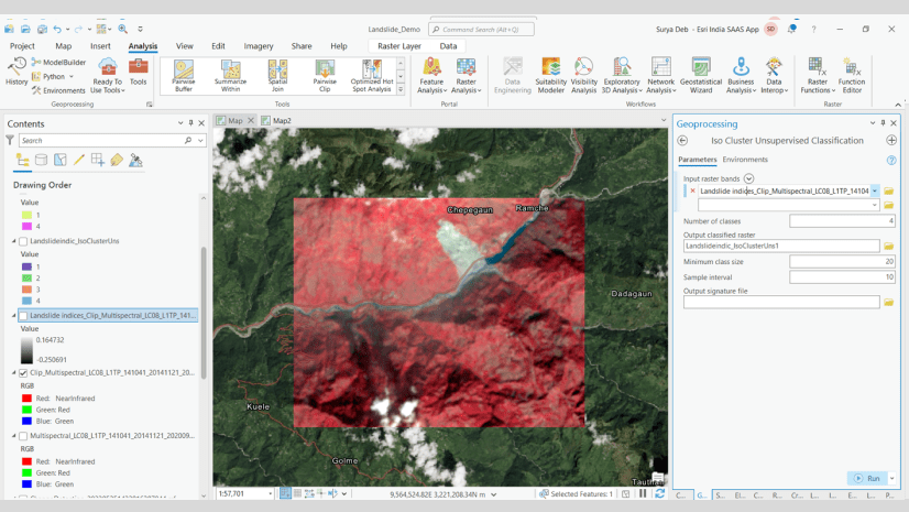

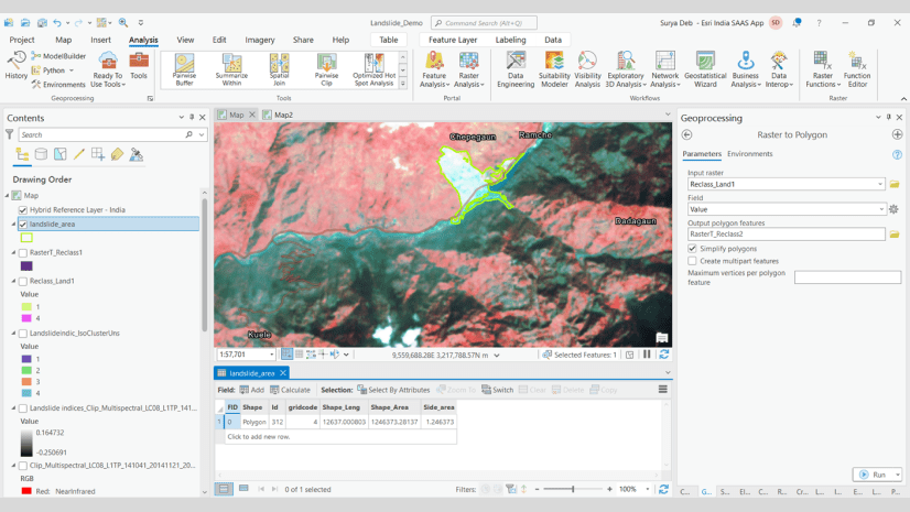

Next, you can proceed with classification. Using the ISO Cluster and supervised classification techniques in the analysis toolbox, you can classify the highlighted area and extract the slide area.
These are the steps involved in identifying a slide area using satellite imagery and remote sensing techniques.

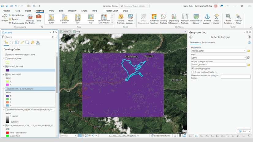

To perform an ISO Cluster Unsupervised classification technique, follow these steps:

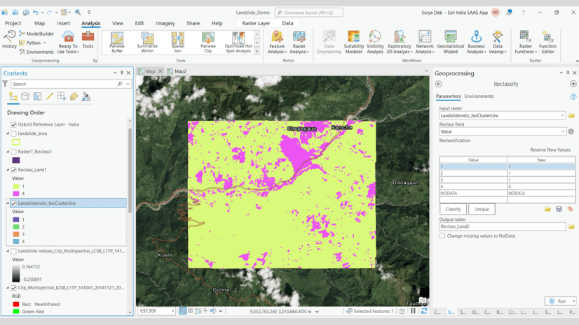

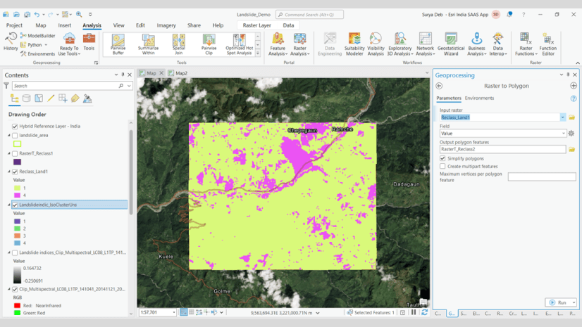

To enhance the slide area, we will perform a reclassification of the image into two classes: slide area and non-slide area. This process aims to differentiate and highlight the specific region of interest on the slide.
To perform re classify we need to go to analysis tab then select tool and under favorite search re classify.

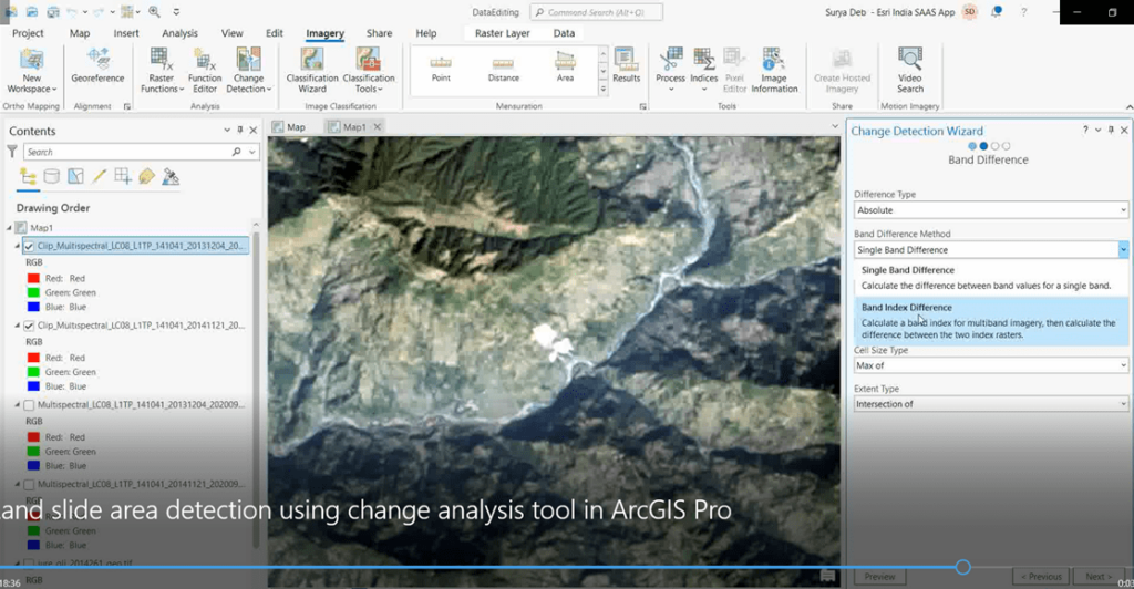

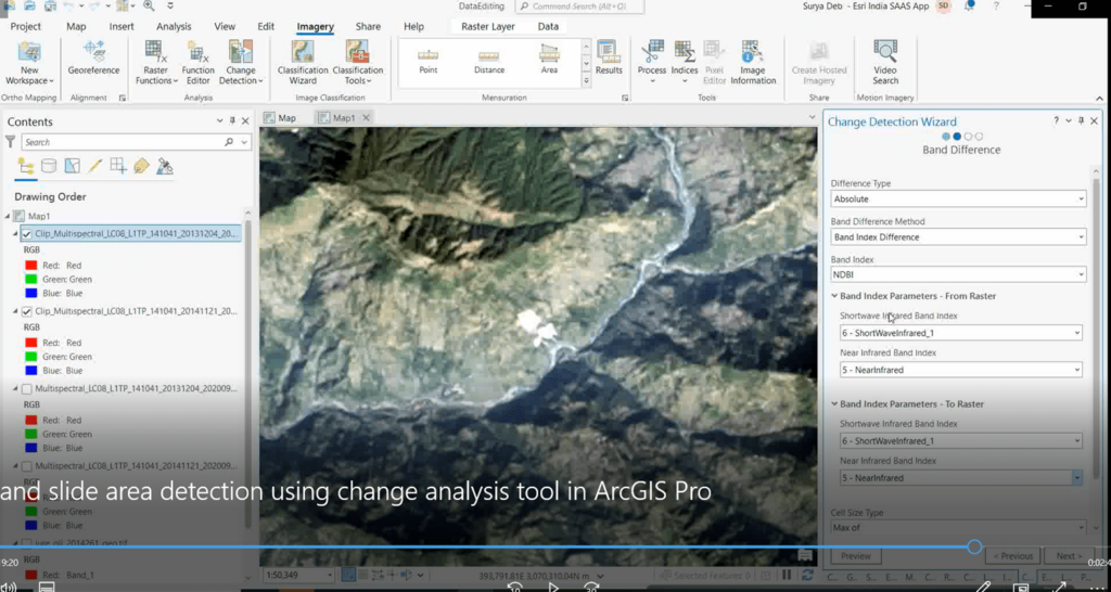

For multi-date analysis, there is a useful tool called the Change Detection Wizard. Select the “Before” image and the “After” image in the wizard. Choose the “Pixel Value Change” option to analyze the differences between the two images. You can select the “Absolute” or “Relative” difference type, and for band differences, choose the indices technique. In this case, we will use the Normalized Difference Built-up Index (NDBI) by selecting the shorter wave Infrared band and the near-infrared band.

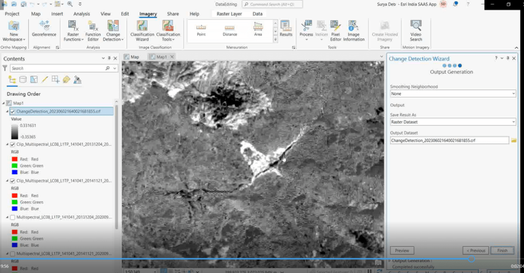

After setting the parameters, click “Next” and check off the “Classify Difference Value” option. Proceed with the next steps and run the analysis. The resulting image will show the changes that occurred after the slide. You can further enhance the image to highlight the slide area.
The advantage of using multi-date images is that they clearly show the changes over time. The unchanged areas will appear similar, while the slide area will stand out. Adjust the visualization settings as needed to emphasize the slide area.
