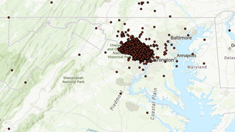

    It is important to note that to create a Space Time Cube, a Point feature class is needed, with the appropriate time information as well. Also, make sure that the points layer has a projected co-ordinate system. The point data in Figure 2 represents each collision and details of all traffic collisions occurring on county and local roadways within Montgomery County, for 8 years.  (Source: Data.gov)
Point Data
Figure 2: Point Data

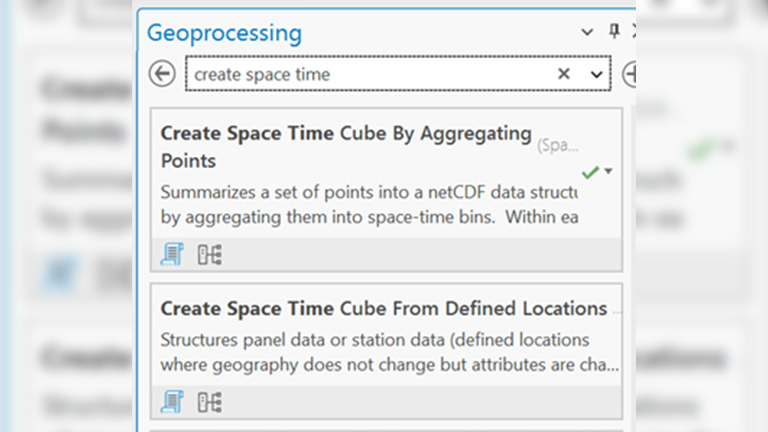

Based on the requirement, a space time cube can be created in 2 ways, either by aggregating points or from defined locations (Figure 3).
‘Create Space Time Cube From Defined Locations’ can be opted when the geography is not varying, but only the values are varying. This can be done when there are fixed points where data is being generated over time.
However, when there is data which represents certain incidences over time, it is sensible to aggregate points over a certain distance.
Figure 3: Create Space Time Cube

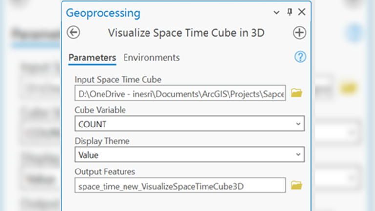

3. Visualize Space Time Cube in 3-D:
Once a space time cube has been created, the space time cube can be visualized in 3D (Figure 4).
Visualize Space Time Cube in 3D
Figure 4: Visualize Space Time Cube in 3D

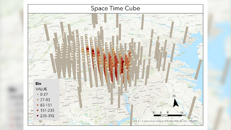

The space time cube can be viewed in 3D in a local scene (Figure 5). The darker values of bins represent a greater number of incidences in that
Space Time Cube
Figure 5: Space Time Cube
place and time. This visualization is useful to understand the scenario of traffic collisions in Montgomery County over a period of 8 years.

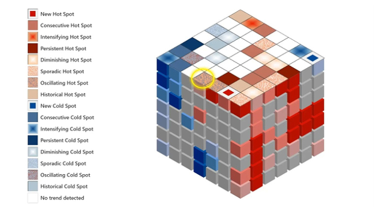

Emerging Hotspot Analysis identifies trends in the clustering of point densities (counts) or values in a space-time cube created using either the Create Space Time Cube by aggregating points, create space time cube from defined locations or create Space Time Cube from Multidimensional Raster Layer tool. Categories include new, consecutive, intensifying, persistent, diminishing, sporadic, oscillating, and historical hot and cold spots (ArcGIS Pro Documentation). It helps detect emerging trends or hotspots in spatial data, indicating areas where there’s a sudden increase or decrease in some phenomenon compared to the surrounding areas.
Understanding Emerging Hotspot Analysis
Figure 6: Understanding Emerging Hotspot Analysis

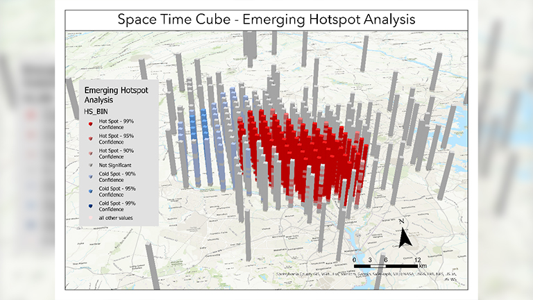

Hotspots and coldspots are identified in the Montogomery data with the help of emerging hotspots analysis (Figure 7).
Emerging Hotspot Analysis on Sample Data
Figure 7: Emerging Hotspot Analysis on Sample Data
