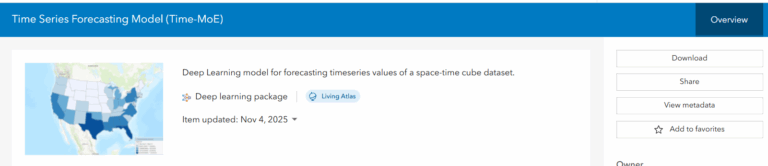

Integrated directly into ArcGIS, Time-MoE is a pretrained time-series foundation model designed to deliver high-quality forecasts without the need for retraining or fine-tuning. Instead of learning from scratch every time, the model already comes with a deep understanding of how time-based data behaves across real-world scenarios. This intelligence comes from its training on Time-300B, a massive corpus containing more than 300 billion time points across diverse domains, including energy systems.

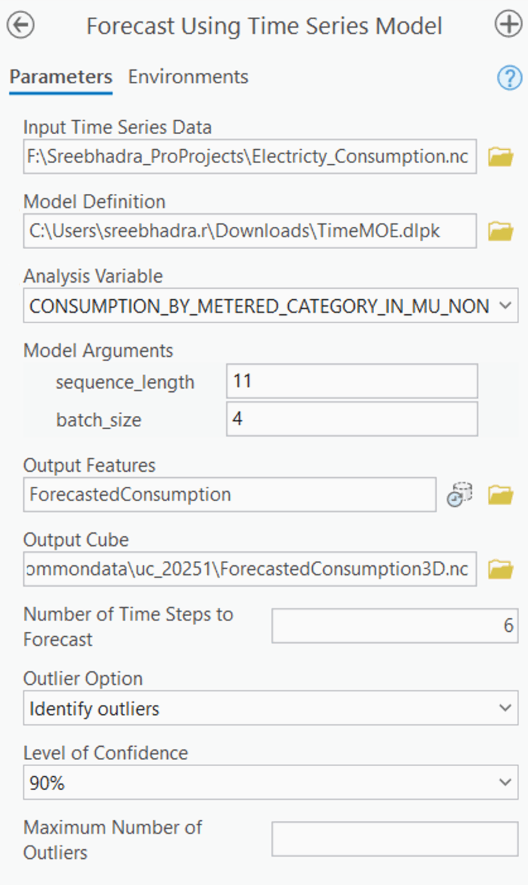

Using the Forecast Using Time Series Model tool in ArcGIS and the Time-MoE model, future electricity demand for the region of interest was projected beyond the historical record. The model first learned how consumption behaved between 2010 to 2023. Then it carried that story forward to forecast the electricity demand all the way from 2024 up to 2029. Rather than guessing what comes next, the model builds on over ten years of actual consumption to shape a far more realistic view of the future. The real advantage of this model lies in its simplicity. Using just two inputs – year and consumption, it was able to forecast electricity demand for the next five years.

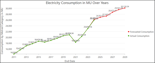

To ensure the forecasts were reliable, the predicted demand for 2024 was compared against the actual consumption for the year 2024. The model forecasted 26,100 MU, while the recorded value was 25,963 MU. This very small difference demonstrates how closely the model’s predictions align with reality, building confidence in its ability to forecast future demand accurately.
forecasting-electricity-demand-figure-3
Figure 3
The resulting graph makes this journey easy to follow. The green line traces the actual electricity consumption over the years, showing how demand has steadily changed based on real usage. Extending from that, the red line steps in to represent the forecast, carrying the story forward into the coming years. Together, the two lines create a clear visual narrative to show where demand has been, and the other shows where it is likely headed next.
