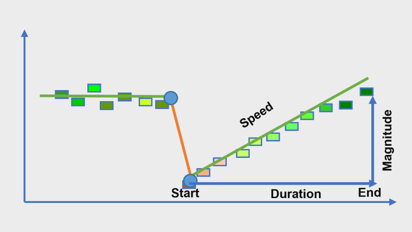

LandTrendr algorithm is based on segmentation of pixel value trajectories over time. In the model, each pixel value is graphed over time and fitted with a linear model. The different line segments indicate various parts of the pixel’s change story. This understanding has been captured in Figure 1 where a linear model is fitted to a single pixel’s values over time. There are points, which have steep changes, have negative changes, a longer, and a slower positive change.
The output from the LandTrendr tool is a change analysis raster, and it contains model information like the start and end date of changes along with change duration and magnitude.

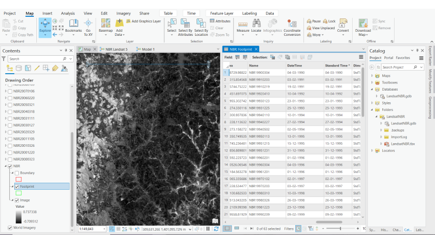

We have chosen Chikkamangaluru district as the study area. 63 cloud free spring season Landsat images spanning over 30 years (1990 to 2020) were downloaded. On average two images have been taken for each season.
To analyze the forest disturbance, an index-based approach is quite efficient. For LandTrendr, any single band index (that represents vegetation) can be used. In our study, we have used NBR i.e. Normalized Burned Ratio. The NBR formula is similar to NDVI, except that the formula combines vegetation sensitive bands i.e. near infrared (NIR) and shortwave infrared (SWIR).
For the current study, NBR was calculated for all 63 Landsat images. Each of these were added to a mosaic dataset. It should be noted that NBRs should have a date component in one of the columns. This date should be the date of acquisition of the Landsat image. All this data preparation activity was done on ArcGIS Pro (as shown in the below image).

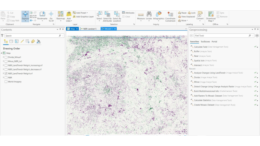

Once the NBR Mosaic Dataset was produced, we used a geoprocessing tool called Analyze Changes Using LandTrendr. All default values were kept for running this tool on NBR Mosaic Dataset. Output was a Cloud Raster Format (CRF) multidimensional raster dataset (Figure 3) containing model information from the LandTrendr analysis.

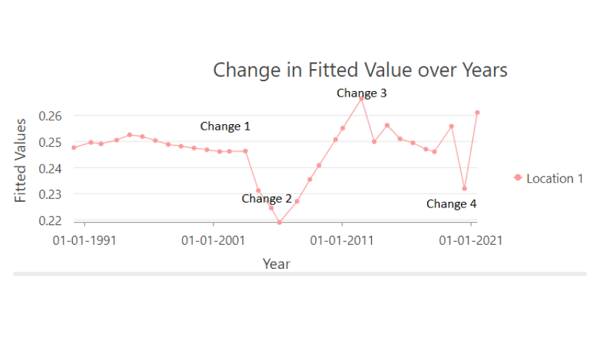

Change analysis raster contains the model coefficients. This modelled FittedValue is included in the output as a band. This provides the pixel value when it is fitted to the modeled line segment at that point in time.
Though model coefficients are difficult to interpret visually, there are additional tools to use to interpret the data. Temporal profile chart can be created to explore pixel changes over time, using the FittedValue band. Changes that have happened over years can be seen in the temporal graph. For example (as in Figure 4), there are 4 changes marked as Change 1, Change 2, Change 3 and Change 4.

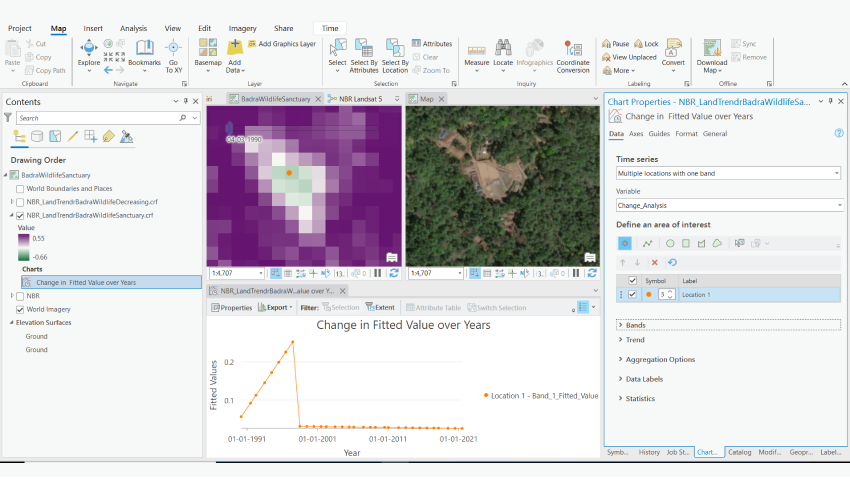

Location 1 (Refer to Figure 6): This location is near Chikkamagaluru city. On click, you will see the graph showing an abrupt decrease in 1997. After 1997, it never recovered back. This is typical case of land clearance.

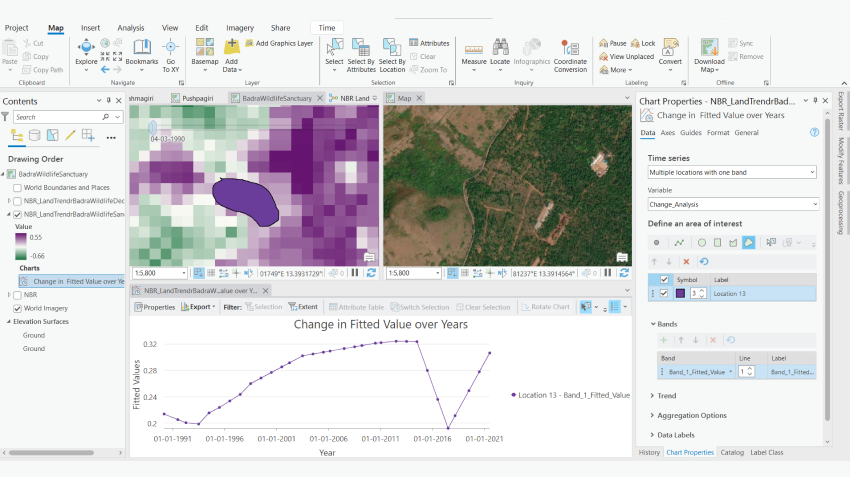

Location 2 (Refer to Figure 7): Now let us explore another location which is at the fringes of the forest. The graph shows gradual increase and then abrupt decrease in NBR followed by increase. This is typical of a forest fire scenario. We have this situation in 2013. Vegetation started improving after 2016.
